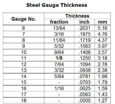

It's only a matter of time and research until the actual records, blueprints, or closeup photos of the various test chassis are found that describe exactly how each of them were made (assuming the frame really was Tucker-built). FYI, here's a list of the specs for the various gauge steel thicknesses:
